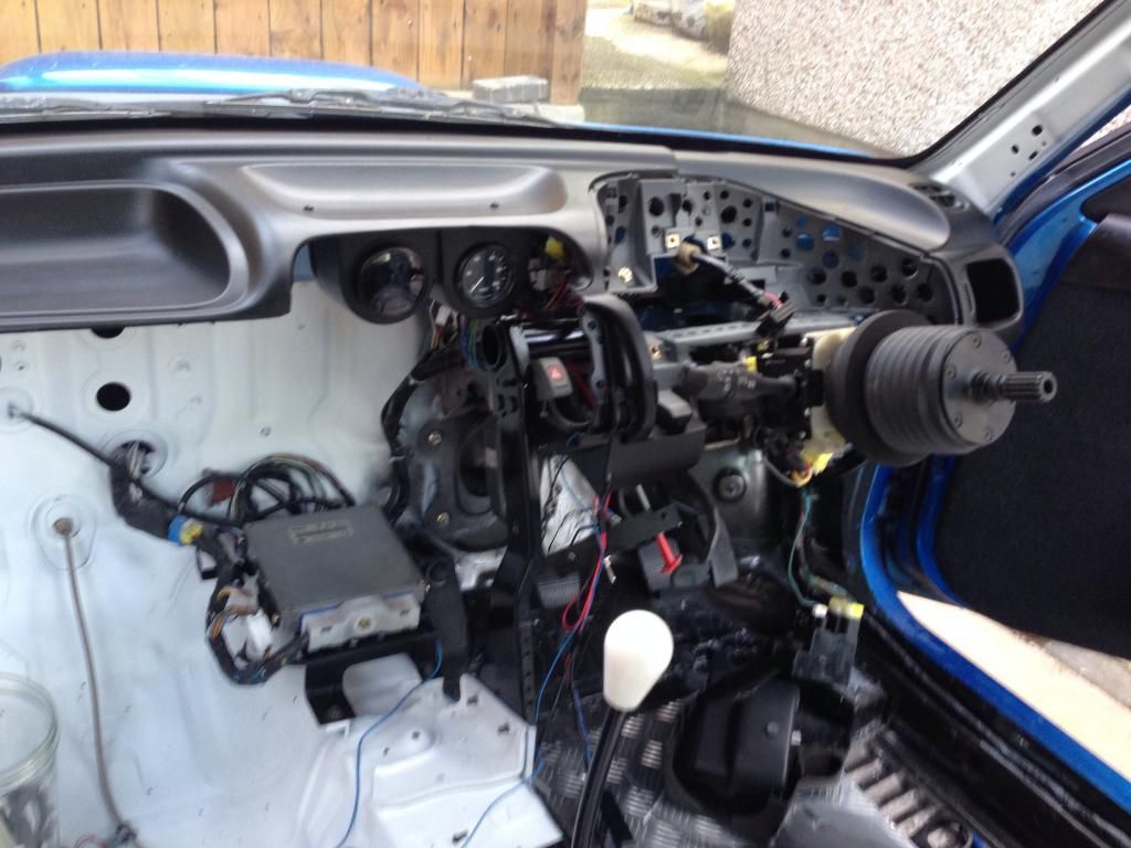

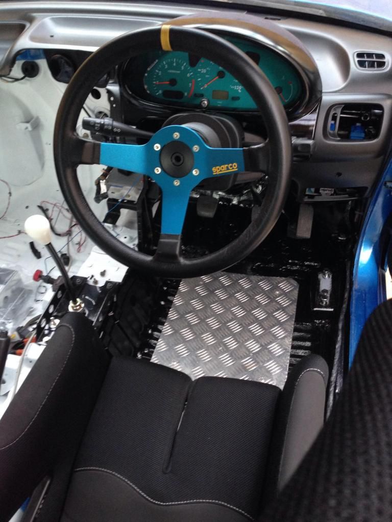

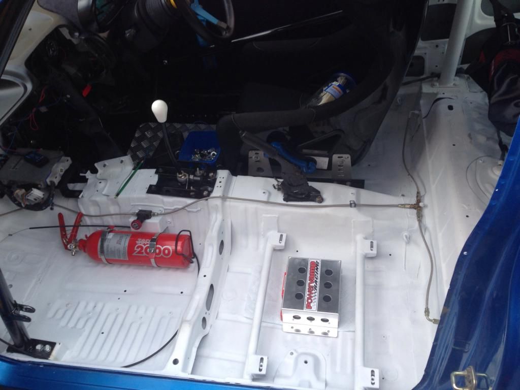

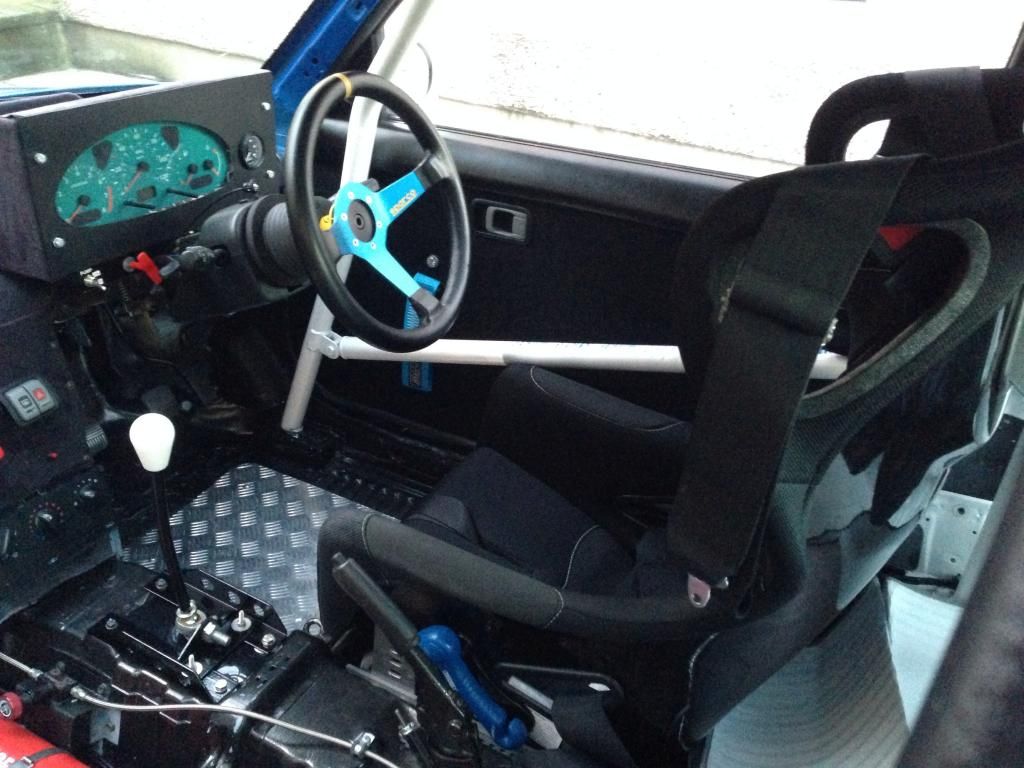

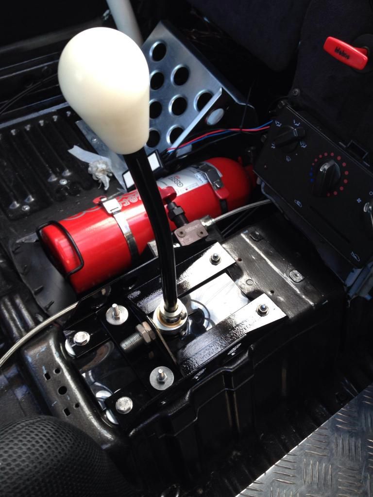

this is or is on the way to being a real short shift mechanism.
this is adjustable to very nice!
how did the gear change feel on fitting,,, little hard to get change in?
did you have a hydro handbrake in there?

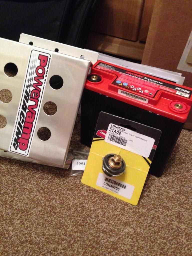

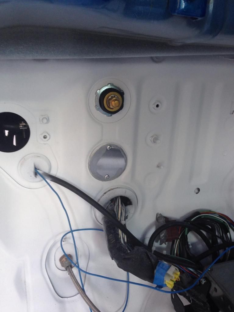

those steering column brackets weigh a fair bit paul, i got mine down to 740kg,s eh, but you,ve added about 100 kg,s with the rally equipment tho http://www.micra.com.au/community/message.php?messageid=64865
There's a point the batteries still factory size at the moment!
They weigh quite a lot with all the liquid acid. Time for a motorbike batt off em TT bikes? Or hand crank? Or push/down hill start.
You mean every GRAM counts !Every KG counts

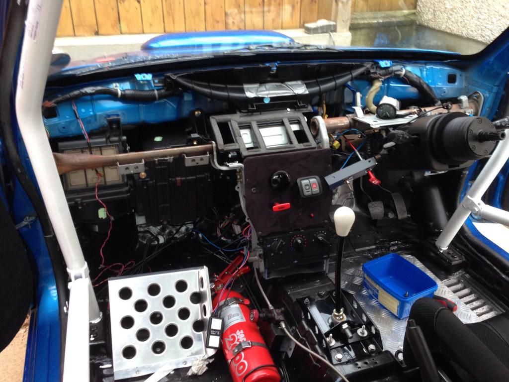

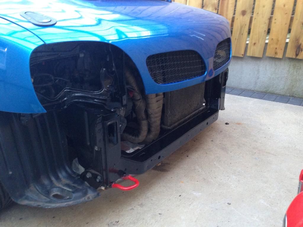

Cars back up running for the first time since the heater removal. A little confused, rads topped up and bled. All hoses are hot and pressurised, rads warm top to bottom but the temp gague on the dash is still resting at cold!
Yep loom to the dials in tight, all plugs to the head in as well. The connectors to the interior fan / heater blower are obviously not connected but that's not part of the wiring for the dials surely?is it connected?
