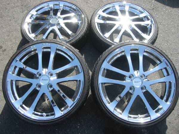

WILL this size wheel& tire fit???!!!

17s would probably through your speedo out, 15s seems to make it more accurate (at least it did for my K11)
I agree with John, even 16s are too big. Anything bigger than 15 would require a bit of work, especially if you're low - low profile tyres to stop scrubbing (maybe even a bit of stretch), and arch roll and flare. Otherwise, you would scrub on even the smallest bumps
Everyone says that 17" need work to fit? Just buy right size wheel...
Nankang makes 165/35 17 tyre, put that on 5 or 5.5 wheel and tuck them deep in the arch, V.I.P. Style :grinning:
