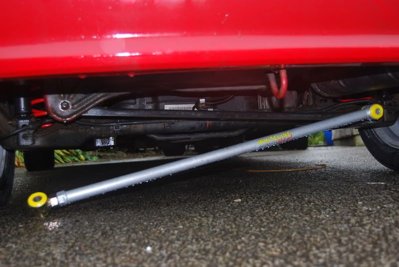

I think i see why it doesnt fit.. If I'm holding it up against the right bits.. pic coming soon :)

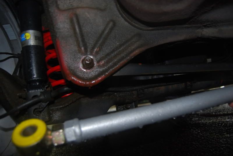

First off, is this where it's meant to go?! :blush:
And if so, this is the problem:
cant you jack the car up at the back which will open it up, check how far in the wheels are sitting when the car is on the ground, if its normal then i dont know what your problem is :p
yearh car should be jacked up when fitting a panhard rod... it doesnt fit a the mo as the rear axle is on the p##s the whiteline one is the right size the standard one should be the same but its not the whiteline one rectefies this problem.
once the rear is jacked up it will fit fine... altough standard one is a ball ache to remove! lol
it will fit, once you take the old one off you will see the axle moves quite alot, so it should fit.
it is deffo a micra one...as said will fit fine, the standard one is shorter as it only copes with 30mm or higher (standard height) the white one copes with lower springs i.e 35mm or lower the panhard rod also takes more strain when the car is lower, thus this one beeing longer as it lines the axle up to its correct postion..
when i lowered mine, it pushed the axle to the right by about 8mm, so my stock p/r is 8mm too long (which was countered by an extra spacer on the n/s wheel :))

Just been outside in the dark :laugh: and measured the one fitted to my car...the bar from where it attaches to the welded collar (where the bush fits) upto the far flat end (where the nut is welded) is about 29 inches long.
I say about, as i the cars to low tbh to get a proper measurement.
But from your picture it does look to long to me (might be an illusion?)...but its possible i may need to retract my original statement about the garage. :blush:

Just seen your tread about the panhard rod and I must say at the moment it looks like we may have had a batch of incorrect panhard rods sent by Whiteline. I will check the others tomorrow and let you know.
Matt
Hi Rob
You are dead right the panhard rod is too long, I've just measure the others I have in stock and they are all bagged up the same with the same part number. I will ring Whiteline on Monday and get some more organised and give you a ring to let you what is happening.
Matt
