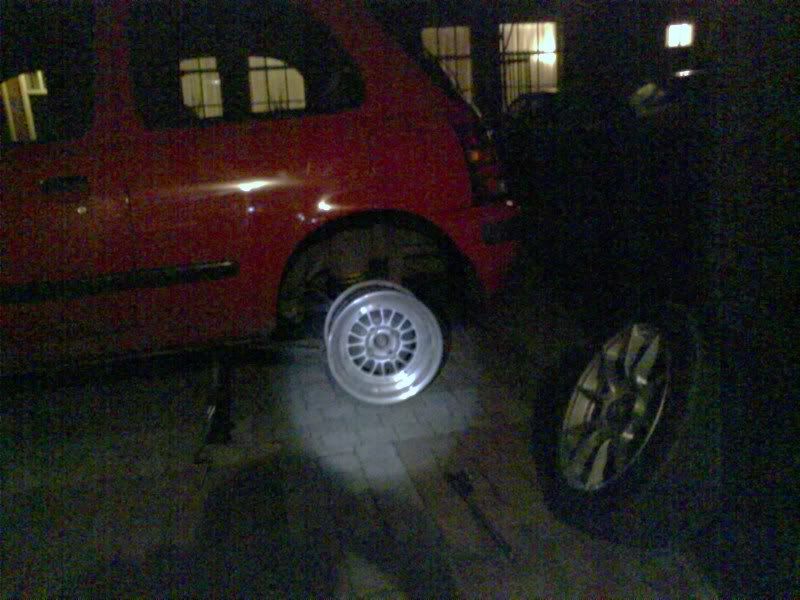

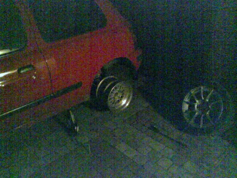

Got these wheels for my micra for when i put the arches on. They are 13in by 8in wide. Have a look and seen what you think?
i think they are a 0j offset. With been a split rim i just choose what outter and inner rim i want. It has a 5 and half inner and 2 and half outer so it's 8in wide.
There a one off rim by bbs i think you can still get them but they are £1000 new

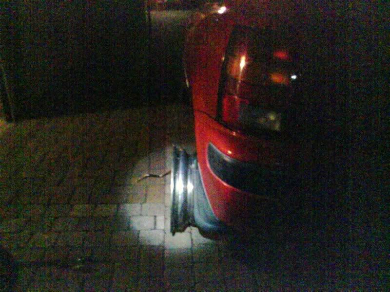

But if you put the arches on they are perfect.
id of thought an 8j 0 offset would be to wide for the arches...but maybe not...have you checked the fronts, as you may be very close to the front struts, especially if you plan on lowering the car / playing with camber later on.
look quite nice though :)
believe me they are on there limit for room wise i think this is the biggest you are going to fit no way you can go any bigger.
There not really a oj ofset because they have a 5 1/2 inner rim and 2 1/2 outer.
Camber wise i'm making up adjustable bottom arms so that i can have the camber i want. but they fit with 1 degree of camber though.

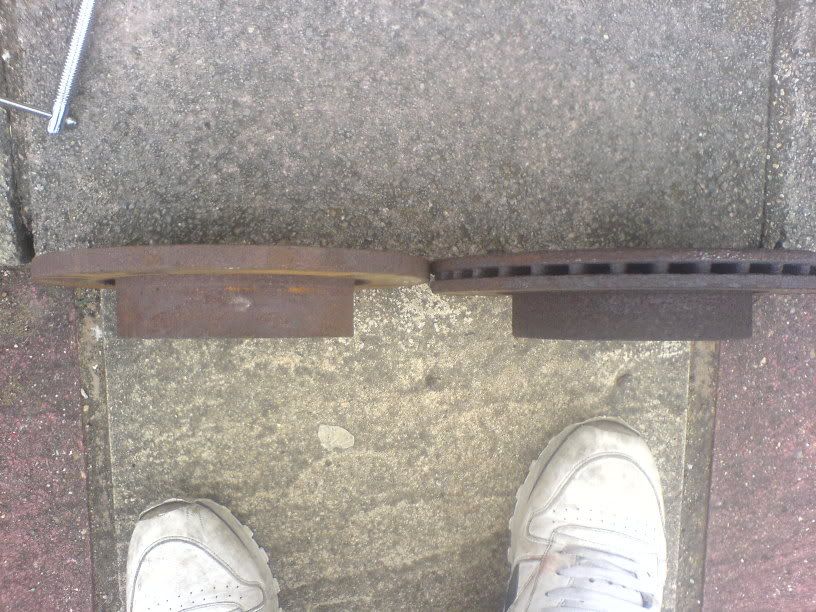

I had (and still do have for sale ;) ) a set of March ST brakes that fit fine underneath 13" steels.
Craig
They use 100nx disks so 240x18mm.
They ar slightly smaller (242mm I believe) than some Almera disks which may explain why they fit.

Sorry, I had completely forgotten, here they are:
This is where the improvement comes from:
Bit of meat in the pads:
