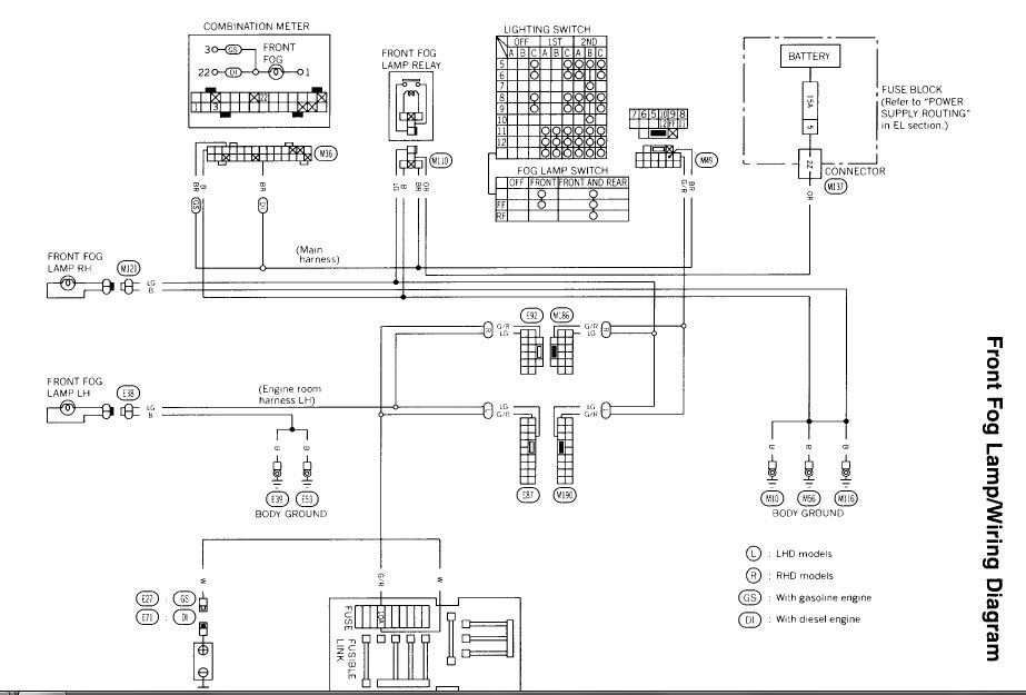

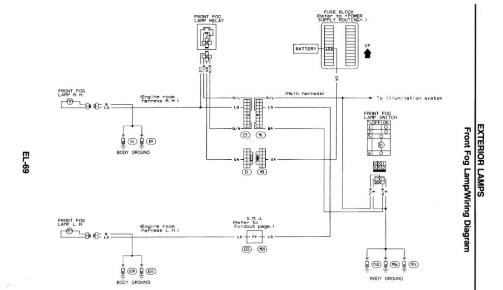

My relay is just a generic black 4 pin one, it is only a switch after all, and that layout is different to in my facelift. Wish my relays were as accessible as that, I had to unscrew one side of the dash! :rolleyes:
