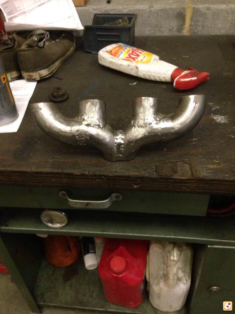

i,ve finished testing the spare engines, and have left 1 in the red car to test different pipe designs andy,What about 4 unequal length stack exhausts poking out the bonnet?
aye thats how 4-2-1,s are usually designed eh, so that you get chuff....chuff....chuff....chuffwhy not join 1 -3 and 2-4?
Edit: or is that how the normal tubular ones are?
1-4 2-3?Janspeed is 1-4 and 3-4...
what scott said >.>1-4 2-3?
just very loud i think neilSounds silly, but would a really short exhaust do it?

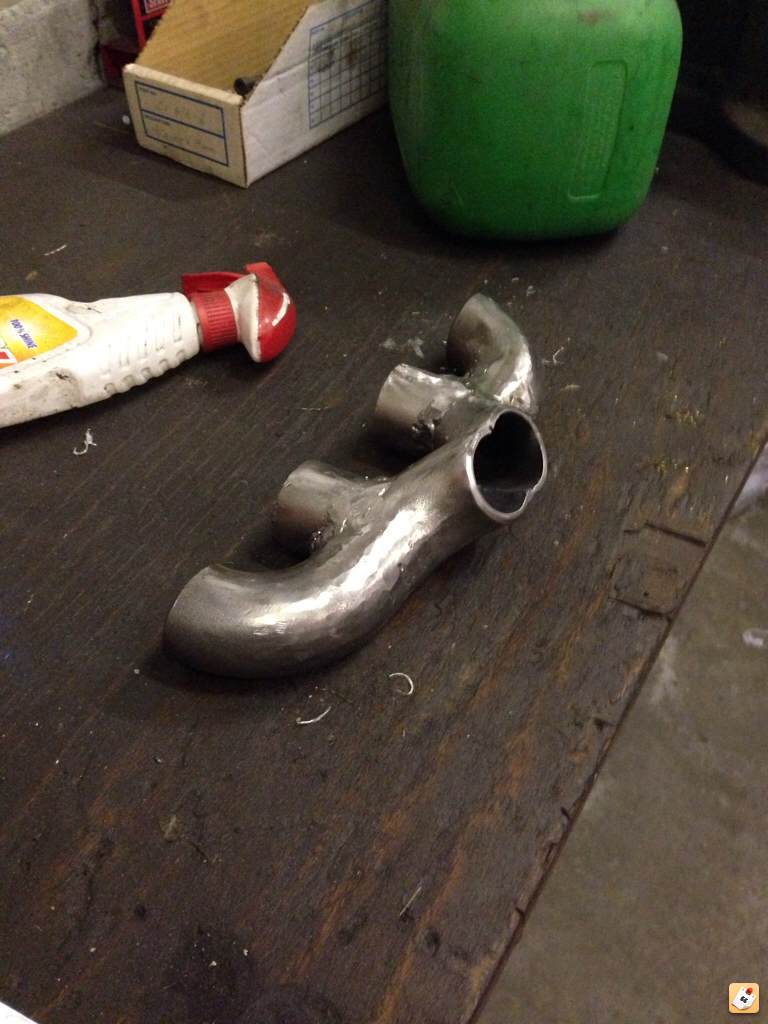

it would still sound like an inline 4 tho andy (unless you had unequal twin pipes, or held your head between the 2 tailpipesHow about have cyls 1-2 and 3-4 join, but keep those 2 seperate all way to back, and have a twin exit?
tiz trueAlmost Neil but you 1 flowing to 2 and 4 flowing to 3 they'll cancel each other out
1 & 2 should be longer than 3 & 4 to create the burble
i think it needs to be slightly off phase andy, else it will sound like a 2CV ! (1..3......4..2...........................1..3.....4..2....................)That's the whle idea is it not Frank? Get cyls 1&2 to pulse together with 3&4 together will give the impression of firing on 2 no?
That'd be what I'd go fori think it needs to be slightly off phase andy, else it will sound like a 2CV ! (1..3......4..2...........................1..3.....4..2....................)
