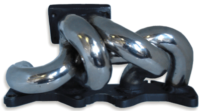

and what about this ??
this what I saw on Cisco site?its a turbo Starlet manifold
Craig said:
I have been giving this a little thought, what about a starlet turbo manifold?
is the base plate the same ?
does someone has a gasket of the starlet to watch if the is wil fit or must mod. it
Unlikely to be a direct fit, but I would have thought that the cylinder spacing would not be too far off, it has a slightly larger bore however.
I am sure that there is a Starlet message board on the net and one of them will have a spare manifold that you can borrow.

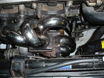

no, there is very few people on the forum with a K11 turbo manifold. And i dont think they want to sell.
problemo solved...........get a standard micra manifold from the scrappy.....find a standard manifold from a 200sx or bluebird turbo, (something with the T2 in it) then, cut off the turbo side of the 200sx manifold, and the car side of the micra manifold.........take it to your nearest college/ university and ask the very nice lecturers in the engineering block to weld some (useless flanges together) please!
one custom made, perfect fit turbo manifold......
ps take acurate drawings of flanges....cut out lots of peices of steel bar and plate........buy some tubing......hire said lecturer from college fr a few pints and a packet of cheesey wotsits...... and make a few pennies...hehehe:wasntme:
