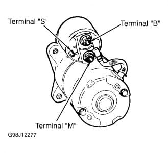

There should be a big connection (a stud with a nut) which is your main battery feed. Then there should be a little connection (either a spade connector or a little stud) which is your ignition feed (when you turn the key)The earth for the startermotor is the engine itself. This is why we need to check that the earth strap is in good condition.
