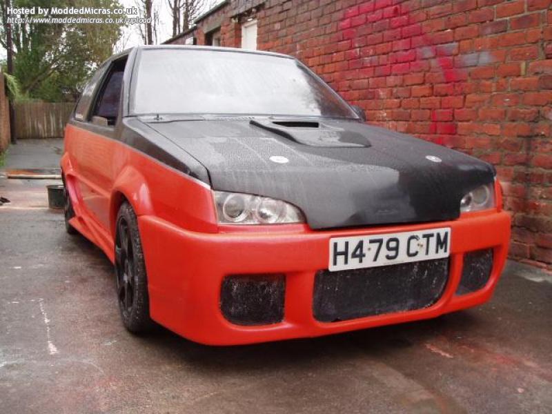

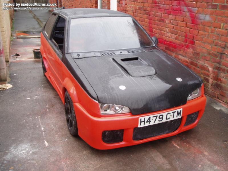

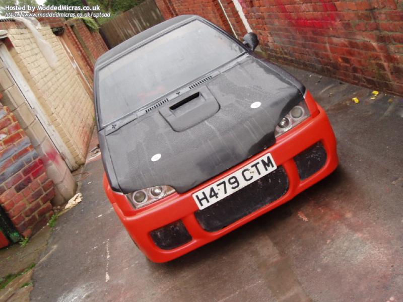

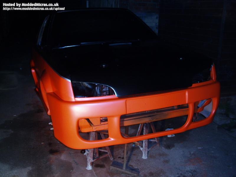

Denji Honda Civic Angel Eyes front headlights, for these we needed a mechanism to flip the bonnet in the opposite direction to the k10 as standard. We firstly tried mini hinges as the bonnet it curved at the back and uses the same idea that we were after. We found that this didn't work and we used clio ones, which were mounted on either side at the rear of the bonnet, and fibreglassed round them so they looked like a part of the car. This worked a treat and the bonnet now flips 90degrees, and also has two struts which life the bonnet up. This now allowed for the badboy to be fitted. k11 bars were moulded into the bumper which made the lights sit a little higher, and custom brackets were made for the lights themselves. The old indicators had a plate welded over them and were smooth and a nice line was put in to follow the line down the side of the car right to the front.

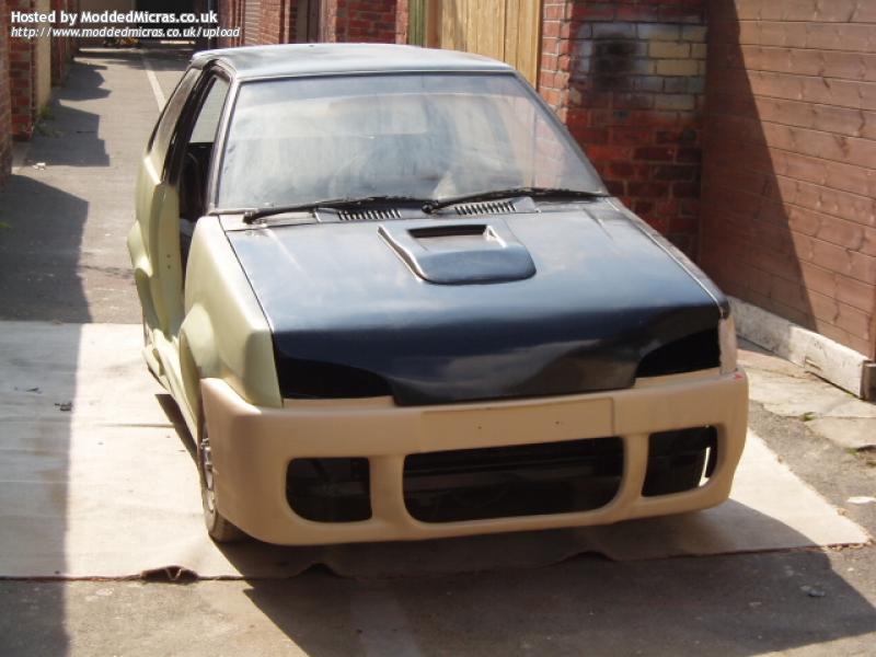

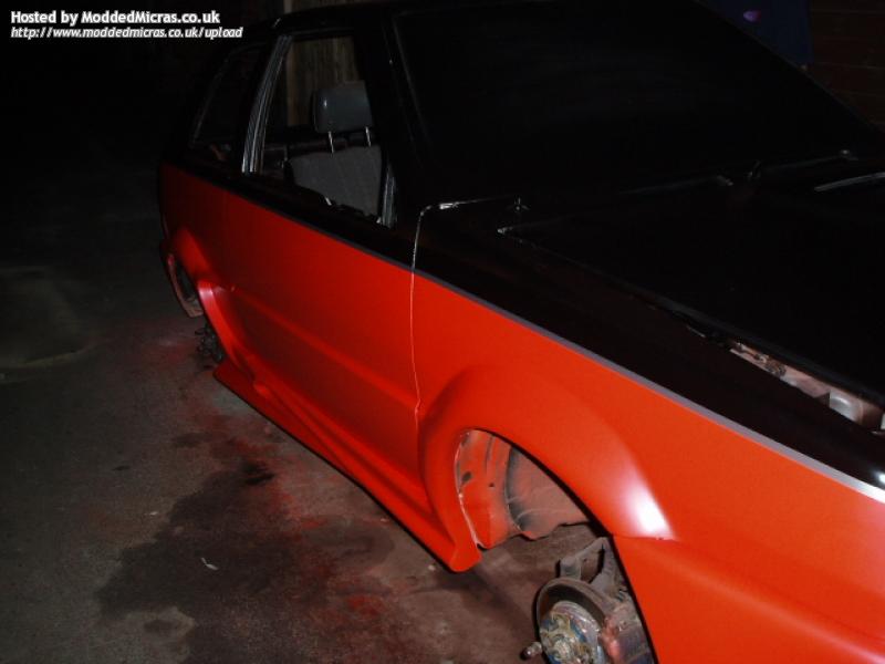

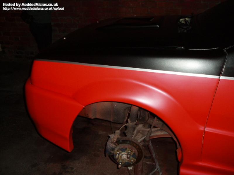

In the mean time this was left and the D&M saxo arches were fitted. Originally on ebay they were advertised as dimma arches and were therefore different to Wayne's, however when they came it turned out that they were infact D&M, and identical to Wayne's car, which neither of us wanted!!! We decided that we could actually modify the rear arches to look similar to the D&M ones which a little extra added touch. This resulted in the arches that I have now, which is one of the nicest additions to the car in my opinion.
Next came the front arches which on first impression appeared to look good, however when they were fitted up against the car they looked far to big and stuck out too much and didn't follow the lines at all of the rest of the car!!! So this meant that we had very little time to find new arches if the work was to continue. I frantically searched on ebay etc, but didn't want to spend alot after the amount I had spent on the set of arches. (which Neil now has the front ones on the bbq... cough cough
) Luckily one of my mates had a mate who was selling a full set of Mk1 XR2 splitters and arches for a bargain of a price!!! And they looked just right too. However when we got them they were actually rubber and it proved to be quite a challenge to fit them because of this. However we got them fitted and they looked great and followed the lines and style of the rear arches really well!!!

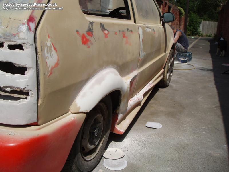

The plan for the car was to go smooth so the handles, indicators were smoothed off and afterwards as an additional plan the roofliner. One of the handles sank slightly but this was fixed and it was looking very smooth. The boot was resmoothed and also added to the look of the car.
Then came the badboy which this was thought was going to be easy, however it turned out to be very complicated. It was hard to get the curve of the bonnet and so the solution was to weld 3 plates on again to make the curve, and this ended up taking much longer than it should have.

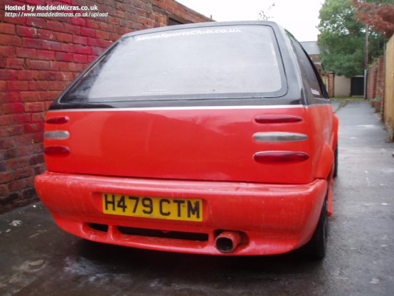

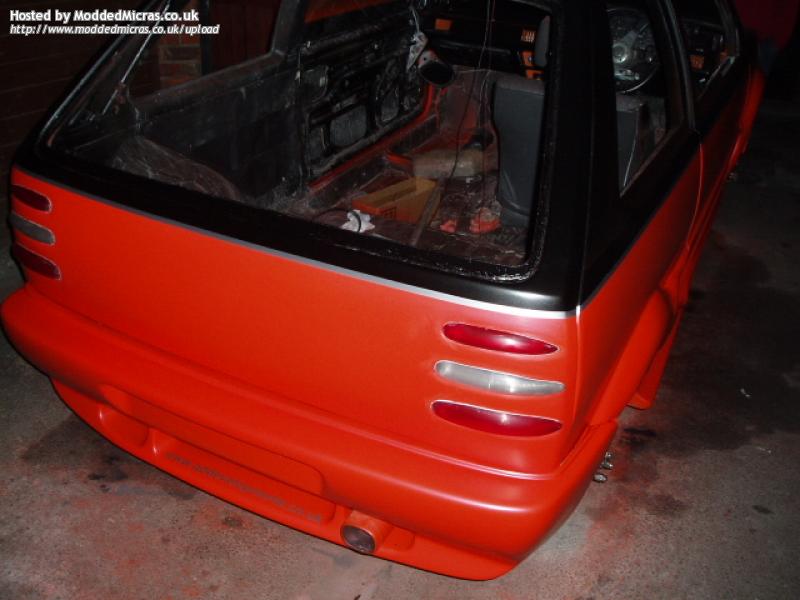

Brava rear light - which after inspection appeared that it would be easier and would look better if they were flush and smoothed into the tailgate. The old tailgate was rusted underneath so Wayne used a new boot and smoothed that and welded 2 additional plates on the sides to keep the curve of the boot and allow the lights to be fitted into the boot. Light cages were made behind the lights to allow the lights to sit in cosily.
After a while it became apparent that the system we had for this wasn't working as the edges were to thin, and the filler kept cracking. A few days later this was solved and it is now a sturdy solid boot, which follows the line of the boot down nicely.

The engine also gave us major grief, which originally was just going to be to spray it up to match the exterior of the car and make it look clean. However we tested the engine, and there was very little compression on 1 cylinder. We decided that as we were sorting out everything we should get this sorted and rebuild the whole engine. On further inspection, we found that the waterways were blocked with muck somehow, so we cleaned the engine got the head skimmed and put a new head gasket on. It was sprayed up and a few parts replaced and fitted back into the car before the car was sprayed. However, we had a problem with the gearbox so that had to be taken out again!!! gr This was sorted and we got the engine running again.

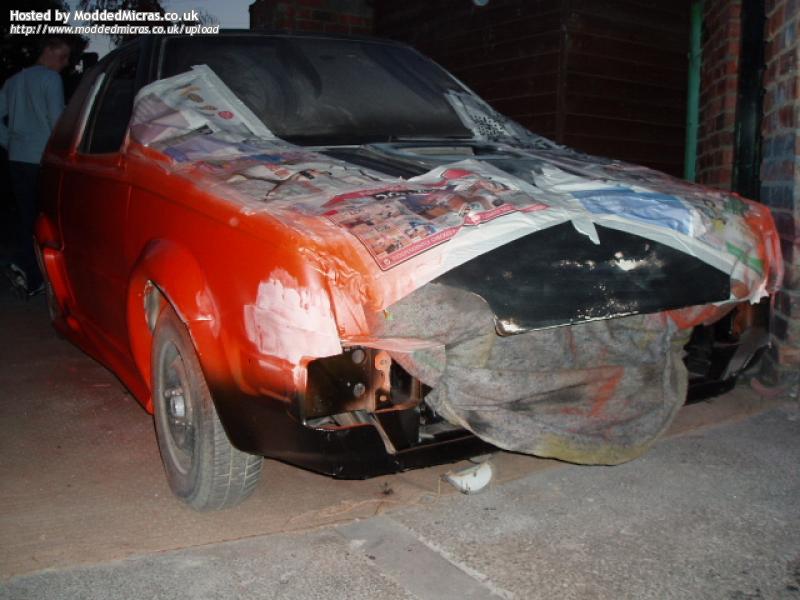

After a few finishing touches the car was pretty much ready for spraying. I must admit the spraying was a little rushed and the orange reacted, meaning it had to be done again. Spraying in the back yard isn't exactly ideal though until he gets his premises. The whole car needed sanding back down again, and the car was polyestered and finished properly before the spraying.

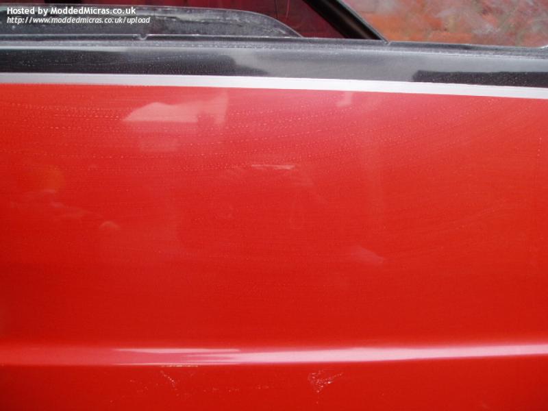

Our next target was Jap Show Finale, which was nearing ever closer to us. With the final repsray just around the corner, everything was done slowly and taken time over. It all looked good, although we were a little short of time. The laquer was put in the day before but didn't go on quite as well as planned as Wayne had never used the show shine laquer before, which although was shiny had a slight orange peel effect. This could have been sorted and the plan was to take the buffer down there and do an early morning session buffing the car lol. I finished work at 5 and headed up to Wayne's just after, he was still working on the car getting it somewhere near, until we met yet another problem!!!

As it stands now it seems like we now have a problem with the clutch gr which will add more time to it been finished, the paint has now been wet and dried and needs a hell of alot of buffing to get it to a spot on shine, which I'm sure it is capable of!!! I want it to shine loads as Wayne knows lol, as the pearl in delicious when it flips and the metallic shines lots too lol. So its just a case of sorting out the remaining problems now and getting the paint up to a nice shine.
Also with the kids next door to his there is a scratch that has appeared which will also need to be sorted, once again not ideal spraying in the back yard, but still that can't be helped at the minute. So not long to go now but after everything that has happened there is no way that I am putting a finish date on it now, as this car has proved that anything that can go wrong will do.
