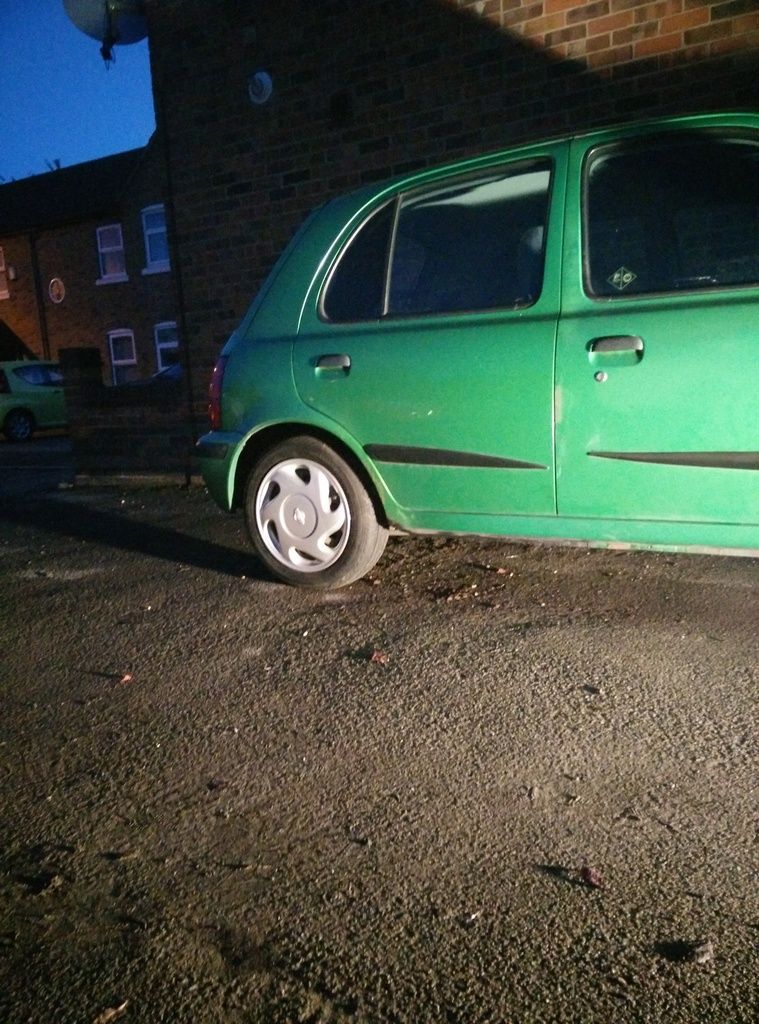

I've put Matiz springs in the front, and after realising the headlights were then pointed at the floor, cut the rear springs down to 290mm, so they stay captive at full droop without the need for a check strap or shorter dampers.
The amount of drop is perfect IMO...there's no longer a massive gap in the arches, but the ride is still perfectly acceptable over bumps. I put Corsa B coilovers in my last K11 but the ground clearance was next to nothing and the ride was rock solid. The Matix springs are a much better option for every day use.

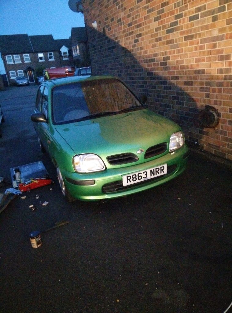

I've painted the chrome bonnet grilles in VHT black. £5 BBQ paint from Aldi. Leaves a lovely satin finish. Yet to see how well it'll hold up.

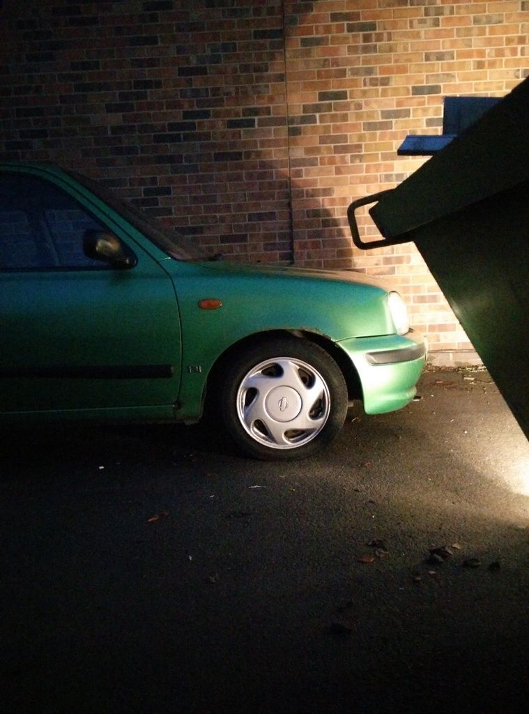

Drop with Matiz springs. You can see the front arch is manky with rust here too. It's rotten through near the sill and the paint is all blistered up above the wheel.
