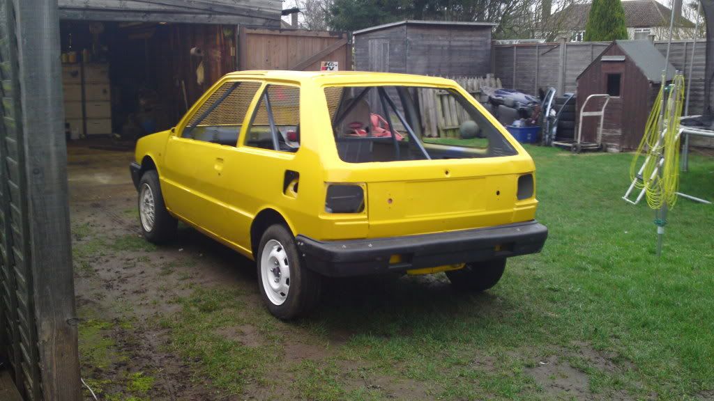

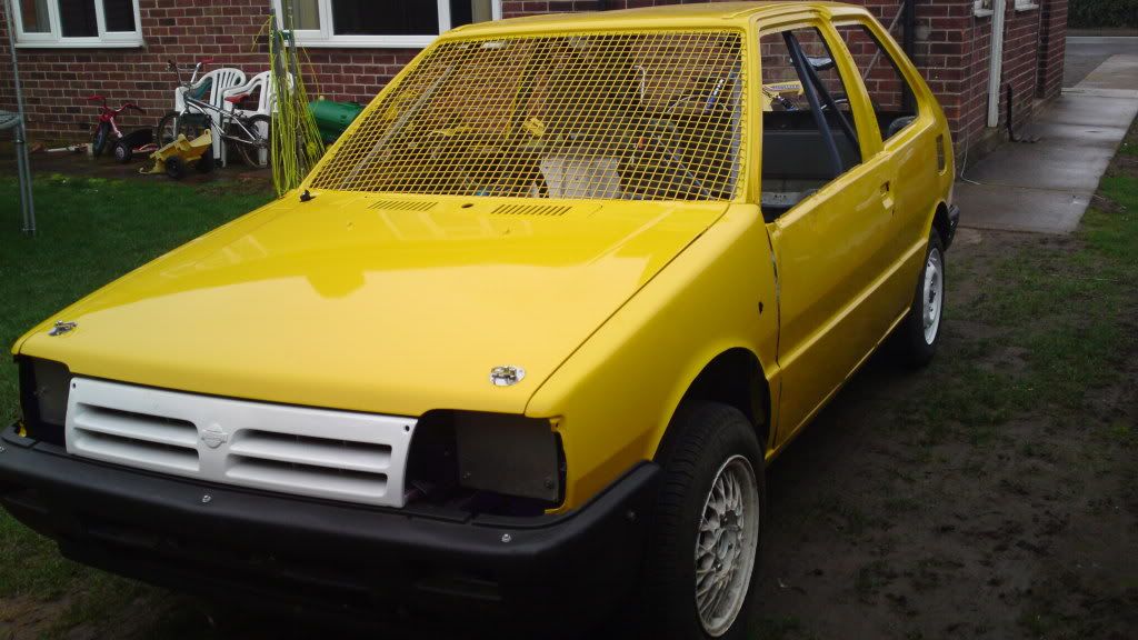

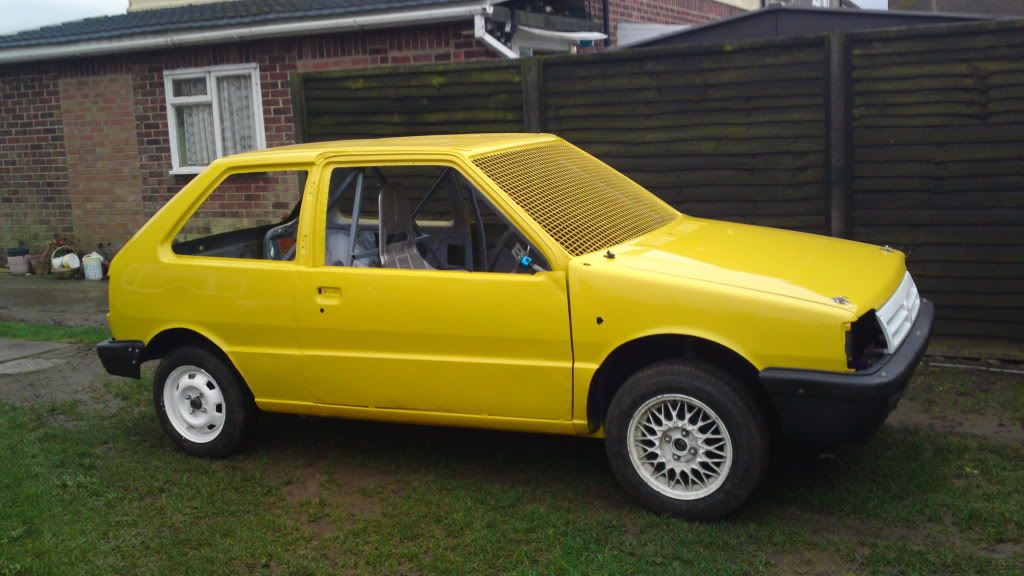

The 2011 season is about to start and his new car is nealy ready.Stickers and on the rolling road next week,will video that too,

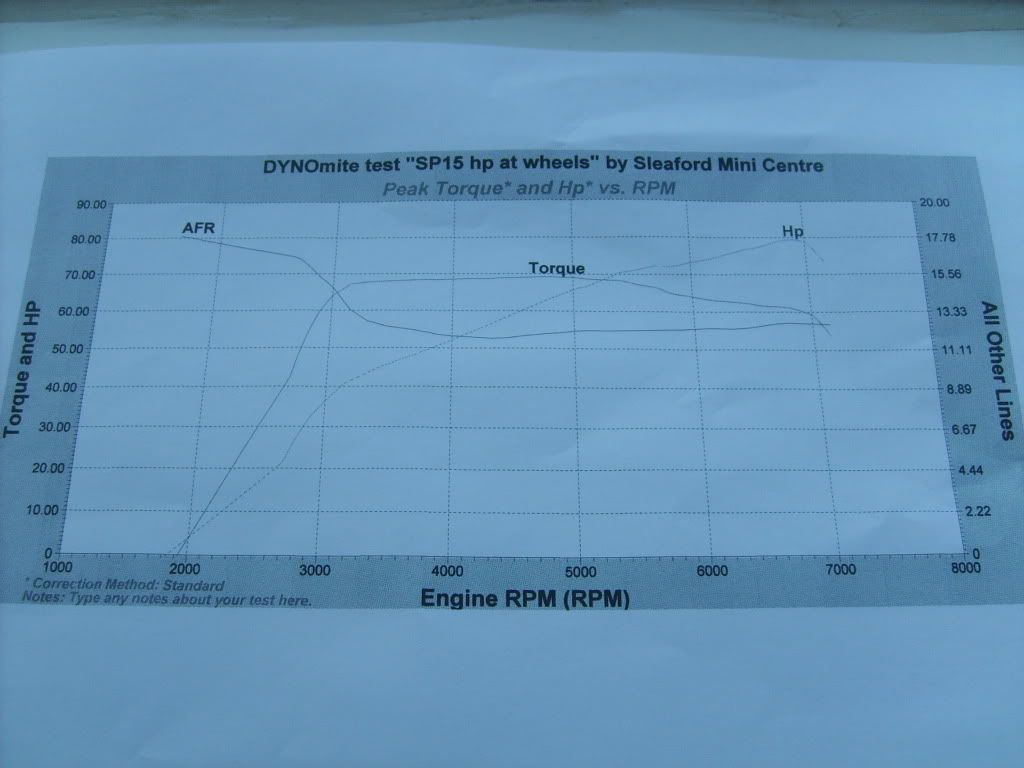

Have been on the rollers this morning 79.8 bhp@ wheels and i am very please with the resuilt here the graph
thats just what the roller man said,,ive done a few micra's before and never have i seen a long and so flat torque line like that before.....why is that anybody no.??? Is it a good thing,,,,because normaly they go up hang around then drop off.
wow... nice range of torque (Y) and max hp arround 6800rpm? nice. mine got it arround 6000rpm
Thats impressive. I love the idea of being able to get 70+hp out of my micra, it seems very fast now and I bet its lucky to be anywhere near its supposed 50bhp being as its 21 years old and done 79000miles.

Bike carbs are pretty easy on a micra if you get some that have the same spacing as cbr600 carbs. They pretty much line up with the port spacing:

no its not just a case of messing with the jets,,,,you have to bin all of the standard inlet and exhaust system and start again...
