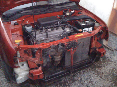

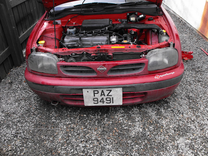

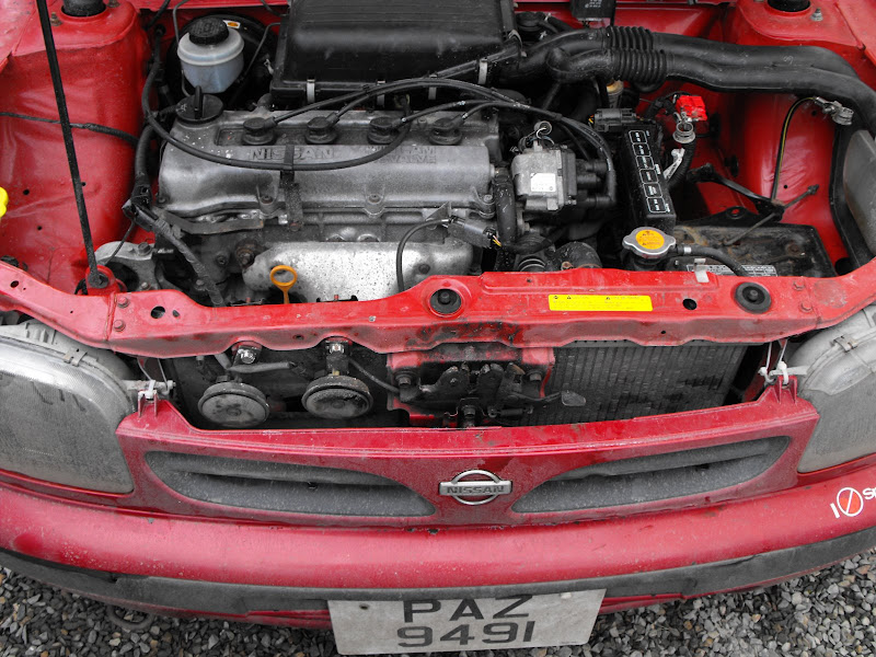

Bought this locally with a broken engine. Didn't even bother to inspect it, metal fragments out exhaust and a chronic oil leak meant I wasn't even going to bother trying to fix it considering a new engine is only a couple of hundred.
Plan is to tidy it up a bit, fire a 1300 engine in and have a bit of fun.

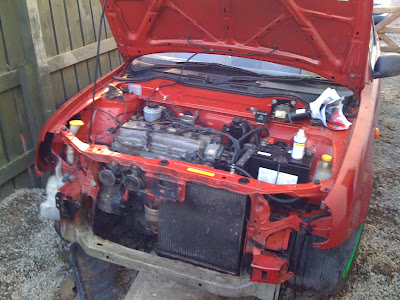

Lifted it at 10am, began work at 11.30am:
GTFO:

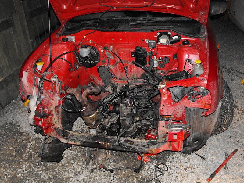

Engine out.
Bit of rot on the cross member as I suspected. Should be patchable but probably going to fit a new cross member to be sure.

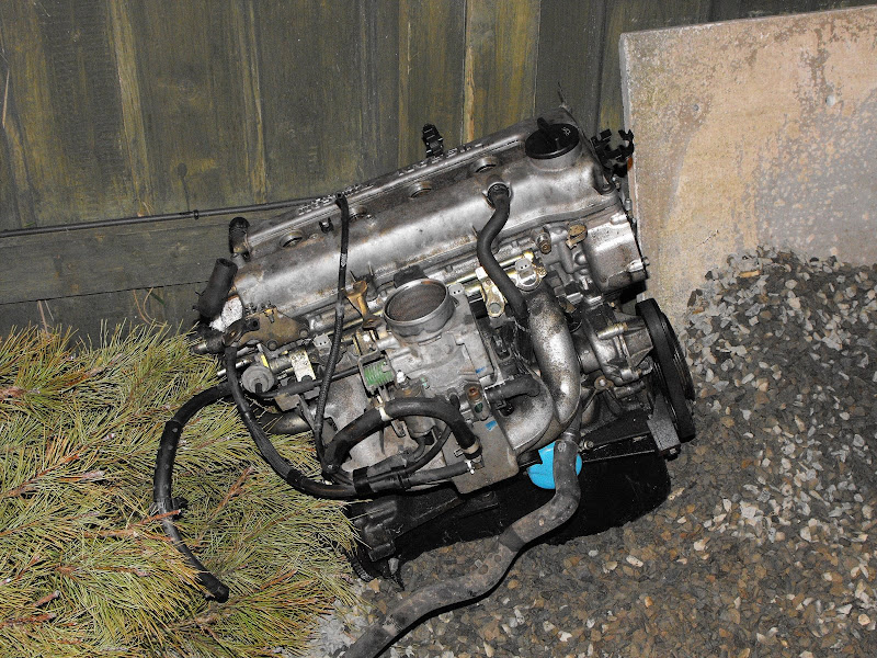

Next up is to pull the rest of the anciliaries off the engine including the flywheel & source a CG13 Micra engine. Also got to change the suspension (cut springs *-)), sort rot out on the sills, clean up the bay, change the rims, tidy the body, etc etc etc :p. Should be ready to rock and roll in a couple of months, funds permitting.
Anyone knows of a CG13 engine out there please give me a shout.

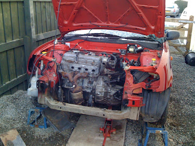

So this morning I had the gearbox bolted up but very little else:
Got the rest of the bits and bobs bolted up and connected, including that severely fiddly connection just sitting above the fapping oil filter :mad:. All I can say is thank #### I took detailed pics of what went where too as the Haynes is no use for some things.
So, got to cranking the engine and wahey, eventually... it started :D
Got the rest of the ancilliaries/electrics/pipes/etc connected and installed and tidied that front cross member a wee bit more. Restarting the engine starts on the first flick of the key, which is brill:
Also drove it all of 3 foot up and down the driveway so seems the clutch is OK, though its a wee bit noisey when disengaged. Not sure whether its because I've had my head basically up against the bell housing or theres something else up. I guess a test drive tomorrow will tell me if all's OK.
