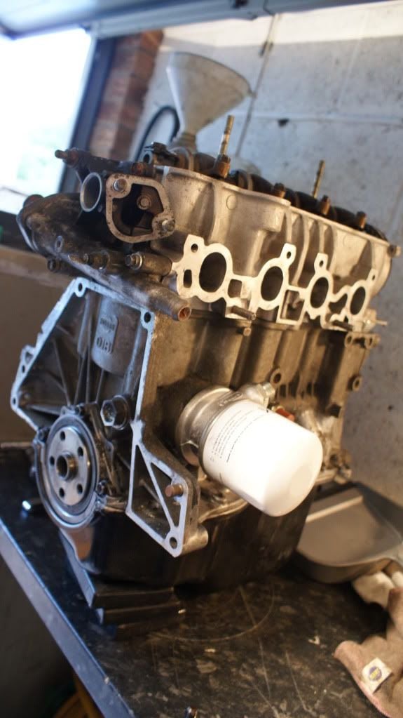

going in a grass track car I guess?would love to know the engine spec
nopenevermind .. though u wer selling it![]()
were can you buy such parts? I am searching almost a year.Big valve head skimmed polished and ported..race cam,,+50 flat top omega pistons on arrow rods arp bolt set,lightened and balanced crank and flywheel tilton paddle clutch.......

Just for them items will cost you £1400
The engine is around 1120cc and will run simlier induction to these http://www.sbdev.co.uk/Fuel_Injection_Kits/2L_Fuel_Injection_Kits.htm
with a dta600 ign
