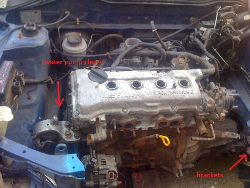

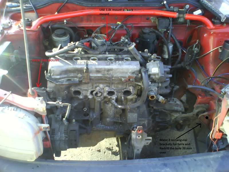

if you look at the pictures you can see the parts that need work. as the engine has been moved over 20 mm then people say you need drive shafts. well this is not true as frank covered ealier in the thread there is about 40mm of space to play with on each shaft means that the original 1.3 shafts fit without modification. You only need to make a front mount but its not necessary to do this. hope this helps a few people.
