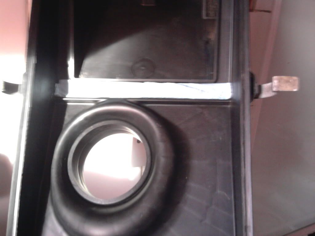

the filter and box arent that good and have 2-3 tiny holes under the box too.(block them)

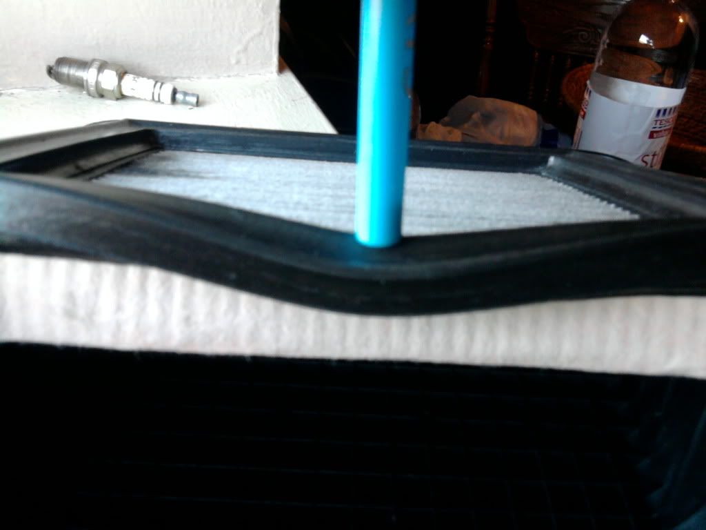

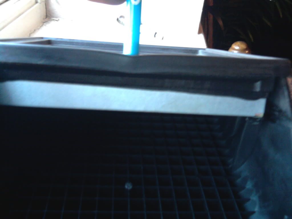

at hard throttle i wonder if its deforming out of shape?

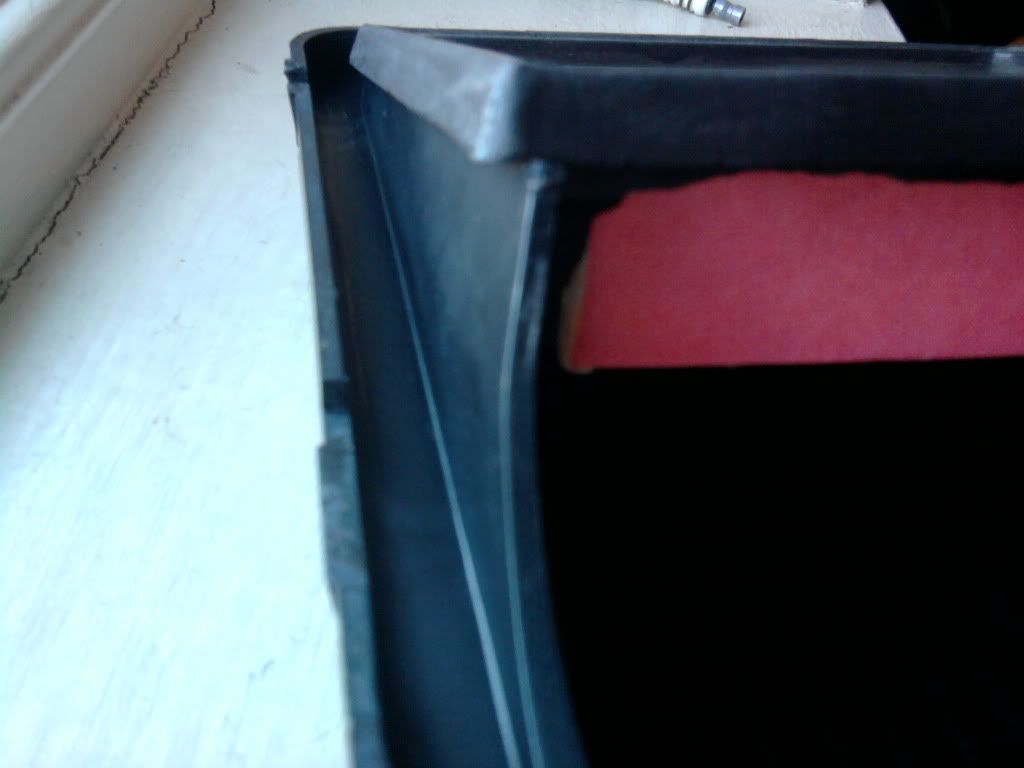

here is the filter housing leaving a nice gap

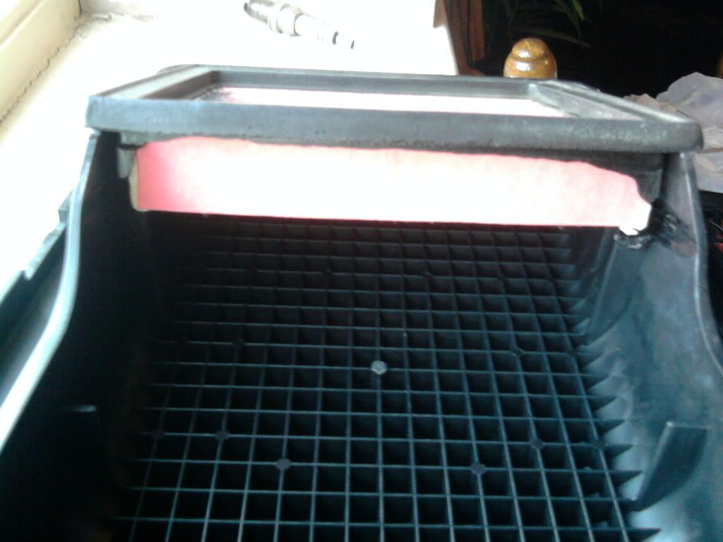

before
after
here is where no filter support is. even worse if you havent got the full metal filter
normal filter
metal rim'd filter more sturdy

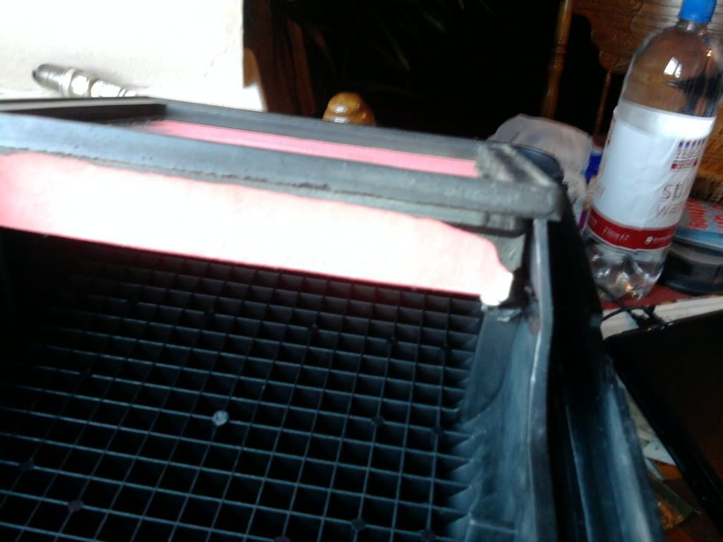

extra support needed here

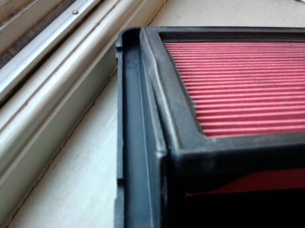

and these side filter support bent in here ,softend with the solder iron
before
after
