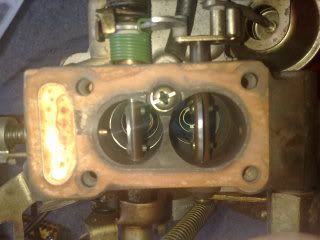

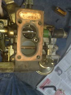

While low performance carburetors may have only one barrel, most carburetors have more than one venturi, or "barrel", most commonly a two barrel, with 4 barrels being common in higher performance larger displacement engines, to accommodate the higher air flow rate with larger engine displacement. Multi-barrel carburetors can have non-identical primary and secondary barrel{s} of different sizes and calibrated to deliver different air/fuel mixtures; they can be actuated by the linkage or by engine vacuum in "progressive" fashion, so that the secondary barrels do not begin to open until the primaries are almost completely open. This is a desirable characteristic which maximizes airflow through the primary barrel(s) at most engine speeds, thereby maximizing the pressure "signal" from the venturis, but reduces the restriction in airflow at high speeds by adding cross-sectional area for greater airflow. These advantages may not be important in high-performance applications where part throttle operation is irrelevant, and the primaries and secondaries may all open at once, for simplicity and reliability
Hope this is usefull.
