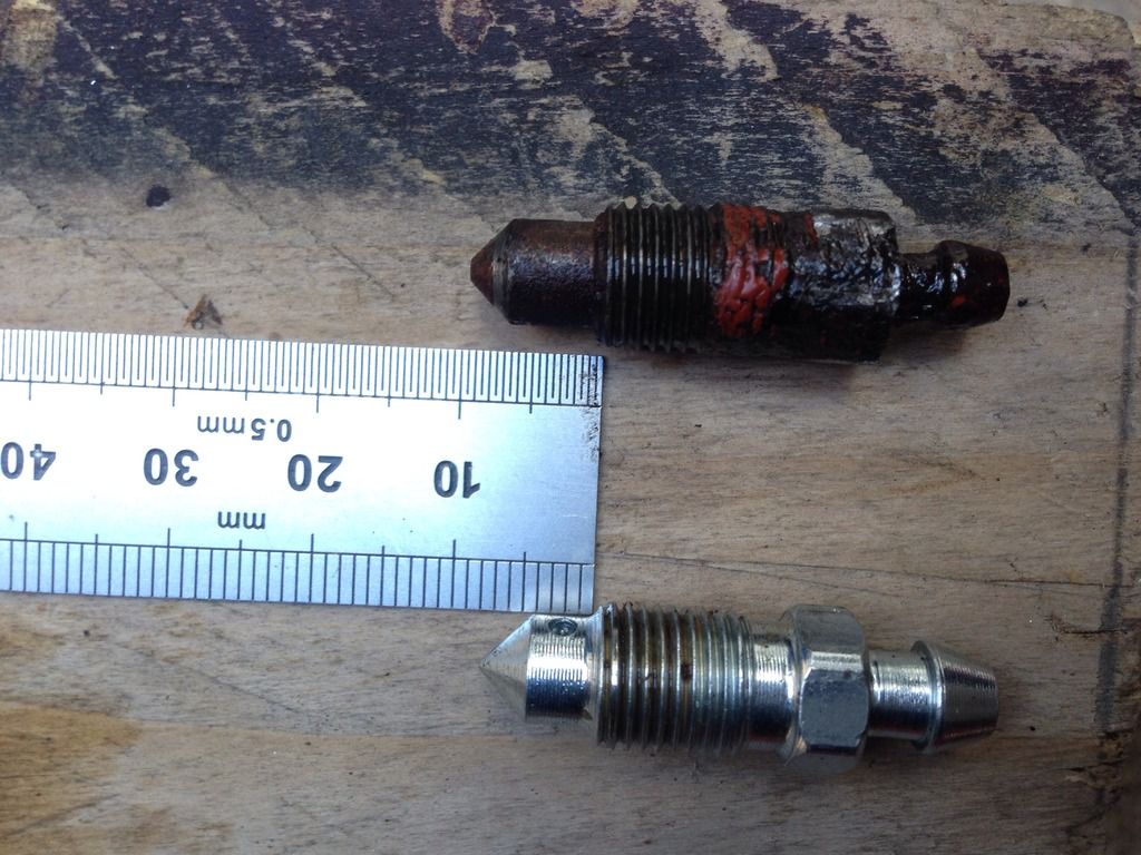

Evening gents thank you all for the help.A few delicate hours with a file but 2.5 threads ground off the stainless bleed screw and it's sealing like a goodun.Typical they are all different sizes!
