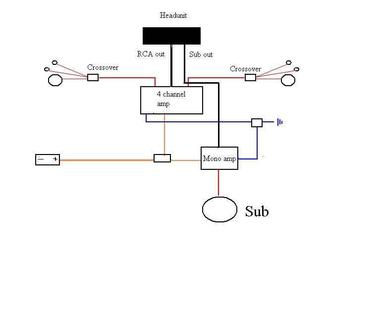

ok i have got miselfe a mono, rockford fosgate p 600-1. 600w rms.
now i want to be sure about the set up, have never done two amps, is it just as simple as this?
or do the amps need to be connected to eachother in anyway. will i need a distribution block?

You've missed the power wiring off of that diagram?
Yes you need a distribution block, one (ideally fused) for the +12v battery side, which splits a 4awg cable down into 2 feeds, 1 for each amp, then one earth distribution block which will take the 2 feeds from the amp and channel that back into one 4awg earth cable (less than 1m in length).
One question, why do you appear to have 2 tweeters on each side?! You definately don't need 2!
I suggest you bridge the 4-channel amp down to 2 channels and run the front components off of these :)
