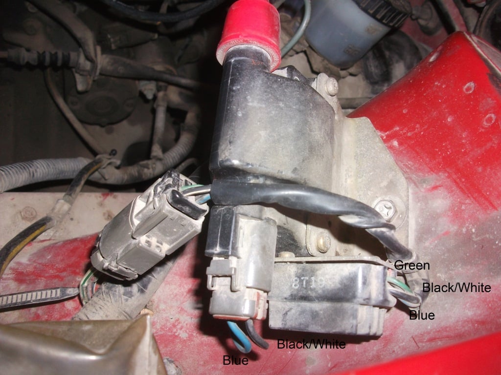

Adding a tachometer for a '89 Cdn spec
Ok, I've searched and searched but my coil set up seems different. It is an odd electronic thing. The wires seem to different colours than the UK 1.2L set up as well. Mine is a Canadian spec car. So I want to take into the neg coil but which wire. Black seems safe but all I have is Black/White but looking for a second opinion. Thoughts? Thanks.
Coil
Dist
No, you have about 4 different looms used in the k10s... well, at least. Sometimes I think they used different wire colours in every k10 :D
It is definitely the blue wire. Never got to it yet as sadly the garage doing my mandatory safety inspection has buggered up my Micra. Spark plug will not fire. Slowly replacing the whole ignition system. :(
