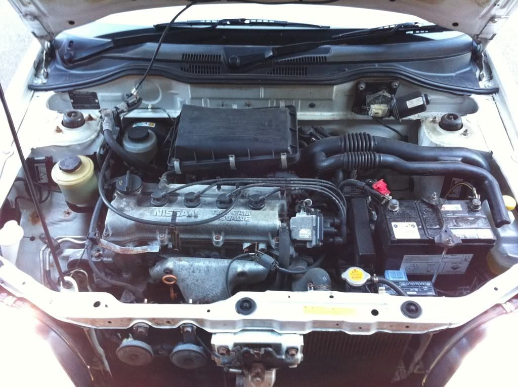

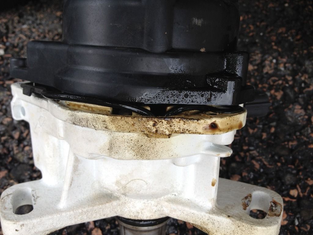

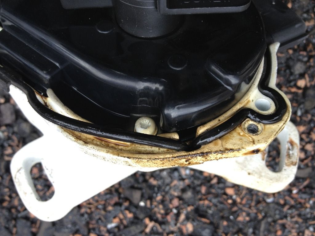

Cheers karl!Well today was my last day off if my long weekend (meant to be spent with the girlfriend and kids) but the micra still wasnt 100% so read for faults codes which showed 55 which means there are none! So i thought it could be the distributor as when we had the engine out i noticed there was oil on the underside but i put it down to spillages. Anyway we tried glens distributor on the car and the car is running great, so off to the scrappies we went to get a replacement also phoned up to book mapping but still awaiting a phonecall back, so excited!
Cheers karl!
